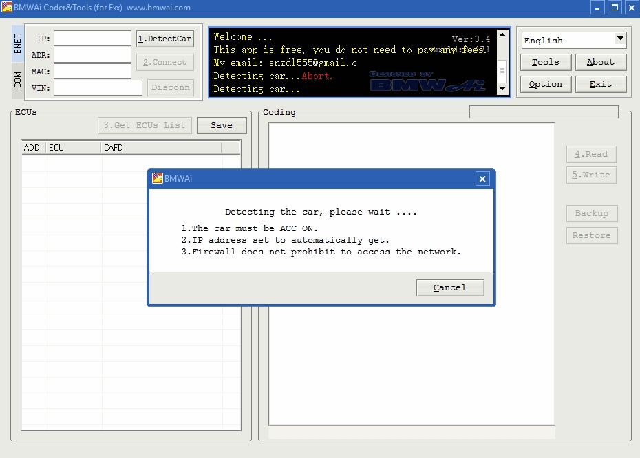

Connect the hardware interface to vehicle and laptop

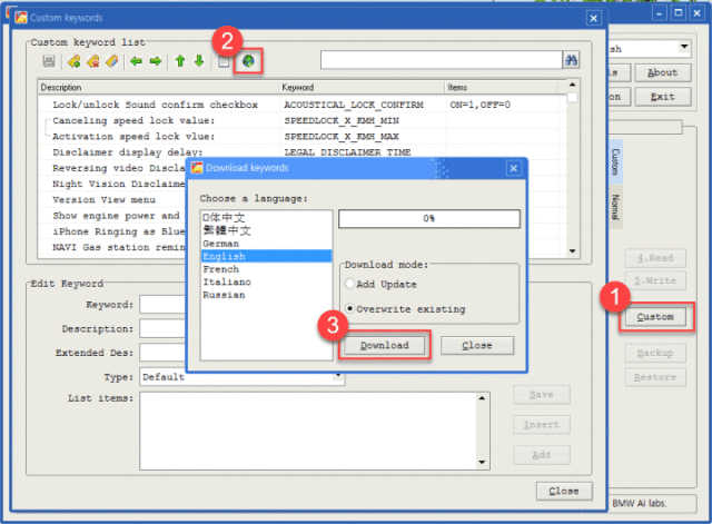

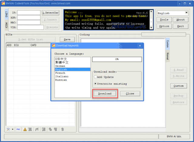

Run the BMWAiCoder software,the keyword download window will open automatically. The process of downloading additional items to be coded on the Internet. Since it will be used in English, press button English while is selected Download.
If you do not see this screen when you first run it, or if you accidentally hand it over, do not worry. Custom You can download it again at any time by pressing Menu.

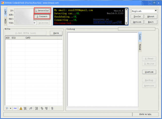

1.Detect Car
2.Connect Press and press to connect to the vehicle.

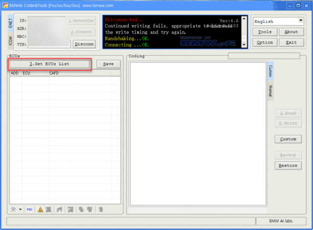

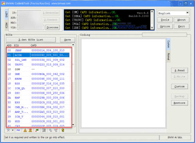

3.Get ECUs List Press to bring up the entire module list.
Select one of the modules you want to code from the ECU list.
4.Read Button to call up a list of coding coordinates that can be made in the module [1]. After changing the value of the desired item, press the [2] 5.Write button to raise the modified value to the vehicle [3].
If you want to cancel the modification and return to the original value, Restoreclick the button.
