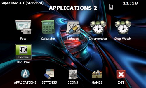

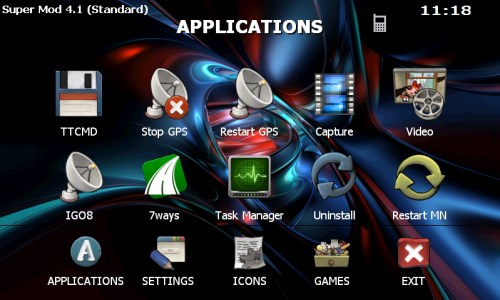

It contains:
- Total Commander
- Start/Stop GPS for allow editing files
- Video player (AVI format 800x400 is the best but plays many other formats)
- Notepad
- Image viewer
- Chronometer
- Screen capture
- iGO8 (an alternative navigation used from USB)
- 7Ways(an alternative navigation used from USB)
- TaskManager
- Restart MediaNav via software
- Calculator

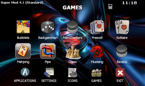

- Games
- Various backgrounds and icons
- HobDrive

SuperMod Screens:
