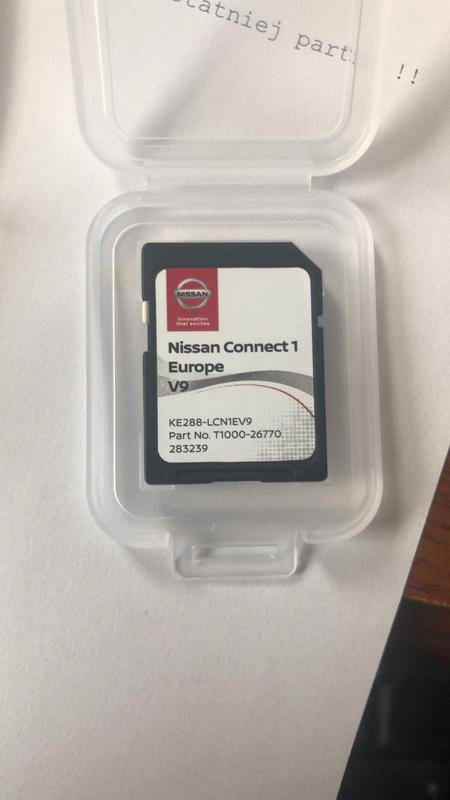

Message par rgmaster3 » ven. 14 juin 2019 23:37
Steps:
1) Change the CID of your SD (or microSD) card to the one mentioned in the cid.txt file;
2) Copy the cryptnav directory and prod_info.txt file to the root of your SD (or microSD) card;
3) Go to your car and insert the SD (or microSD) card.
Nissan Connect 1 systems have a SD slot at the bottom right :
