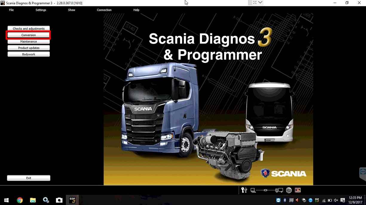

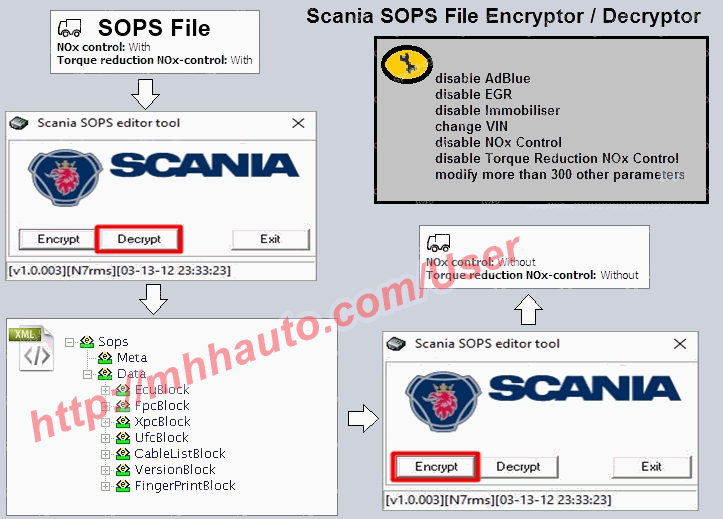

1-You need a program (SDP3)
2-You need a program (XCOM)
3-You need a program (SOPS)
4-You need a program (XML Editor)
5-You need a PDF (SCANIA Parameters)

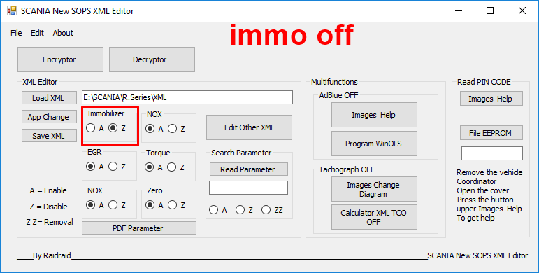

A = Enable
Z = Disable
ZZ= Removal
2344 Immobiliser..............A With
2344 Immobiliser..............Z Without

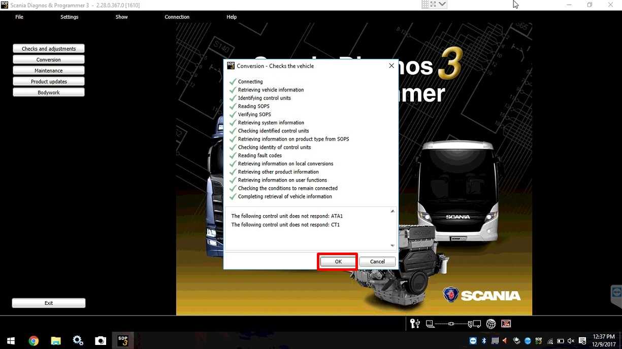

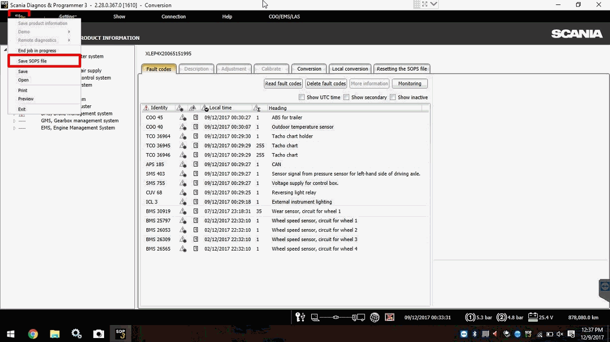

Hi all members interested in scania here i have attached these pictures to show you how you can IMMO-OFF scania with S6 EMS

A = Enable
Z = Disable
ZZ= Removal
